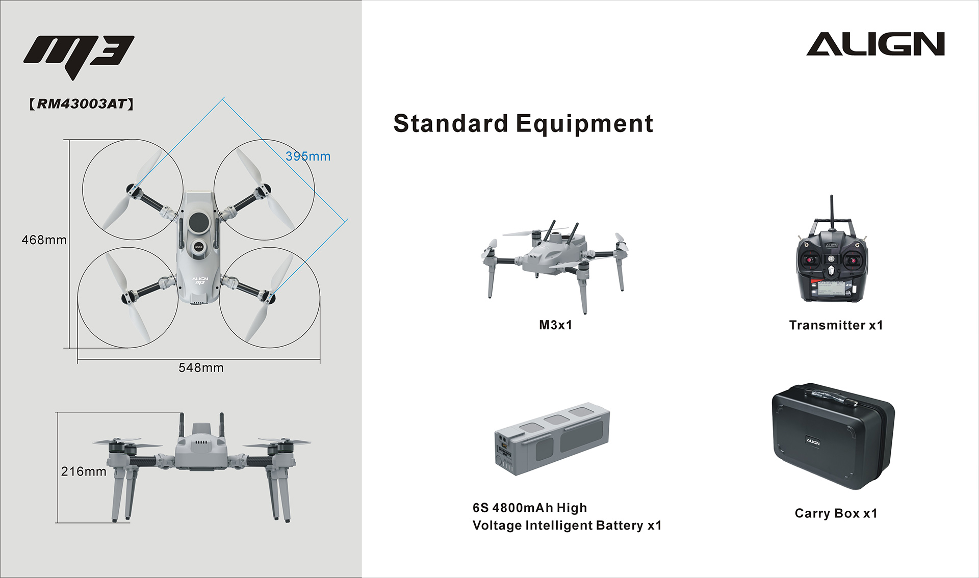

Standard Equipment
●M3 Mission Drone Kit Set x 1
●Transmitter x 1
●GNSS module x 1
●6S 4800mAh High Voltage Intelligent Battery x 1
●Charger x 1

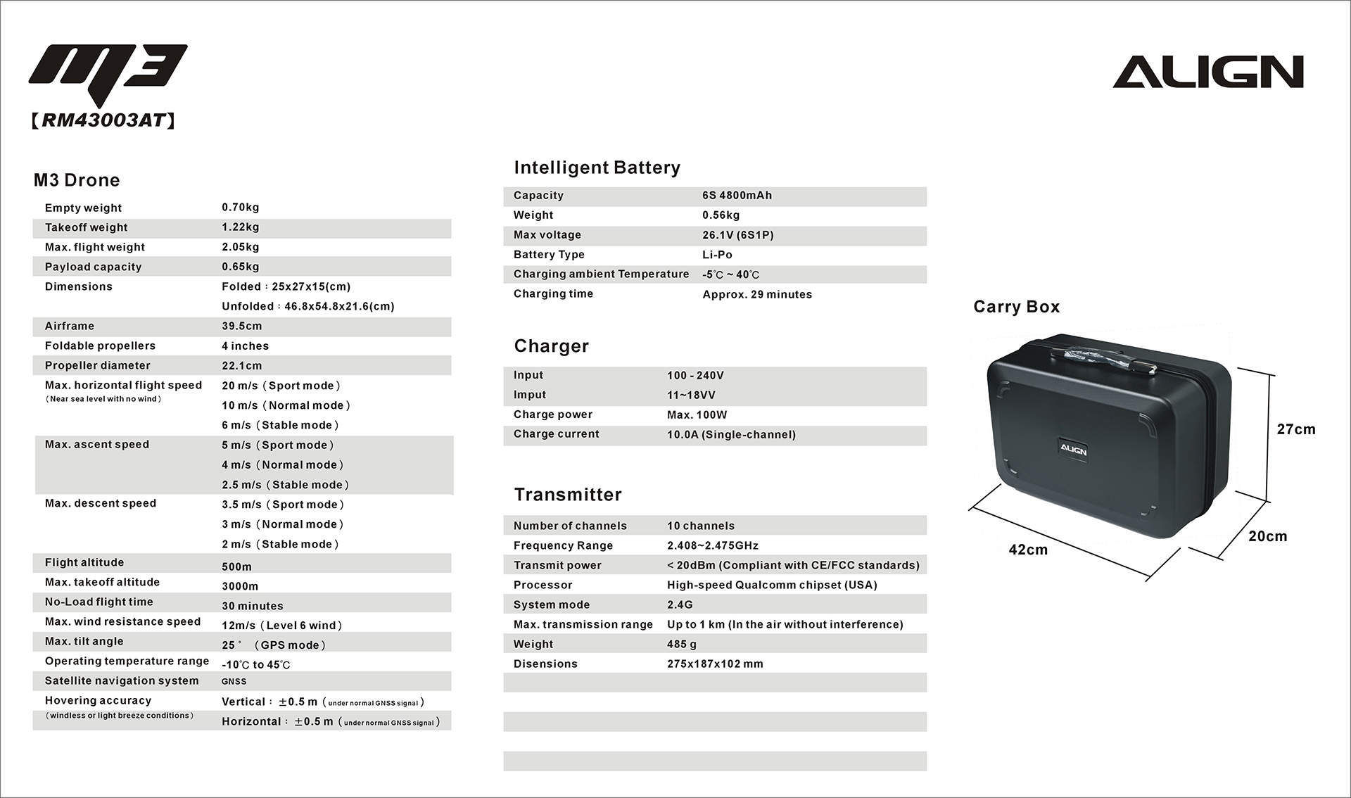

ALIGN M3 Product Specification
●Empty weight:0.7kg
●Takeoff weight:1.22kg
●Max. flight weight:2.05kg
●Payload capacity:0.65kg
●Dimensions:
       Folded:25x27x15(cm)
       Unfolded:46.8x54.8x21.6(cm)
●Airframe:39.5cm
●Foldable propellers:4 inches
●Propeller diameter:22.1cm
●Max. horizontal flight speed:20 m/s(Sport mode)
                             10 m/s(Normal mode)
                             6 m/s(Stable mode)
●Max. ascent speed:5 m/s(Sport mode)
                       4 m/s(Normal mode)
                       2.5 m/s(Stable mode)
●Max. descent speed:3.5 m/s(Sport mode)
                       3 m/s(Normal mode)
                       2 m/s(Stable mode)
●Flight altitude:500m
●Max. takeoff altitude:3000m
●No-Load flight time:25 minutes
●Max. wind resistance speed:12m/s(Level 6 wind)
●Max. tilt angle:25 °(GPS mode)
●Operating temperature range:-10℃ to 45℃
●Satellite navigation system:GNSS module
●Hovering accuracy:
               Vertical:±0.5m(under normal GNSS signal)
               Horizontal:±0.5m(under normal GNSS signal)
